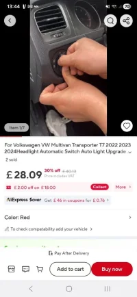

So that you when the sun is out your headlight are turned off and when you go in a tunnel your headlight will turn on automatic.
And android auto or carplay will have a white screen instead of dark when your headlights are on!
I know this is an oldish post...... But thanks for the info you supplied. I ordered the same and works fine also on my T6.1 not yet worked out why the screen on the head unit still Dims though, any thoughts?

Could it be that with android auto / carplay settings you have it set to dark and not automatic?
Im really impressed with mine, I did reorder one with the sensor on a lead as I found the light on / off better controlled as the integrated one was most in the shade so dip beam was coming on in the daytime
This is exactly what I'm looking for @Pedro20001. Do you have a link to switch with the sensor on a lead? I assume you just mount it on the dash?
Hi buddy, yes just put the sensor on the dash ( out of sight when driving near the screen. I used one from aliexpress
Pleased to report the new switch (without lead) has gone in today without issue even on my ancient 2020 6.1. Works well.
Nothing on the display but Carista does come up with a new resettable lights error, but no angry lights on dash... Jobsagoodun. Thanks folks!
Appears the integrated one works exactly as the OEM on my Highline T6! :cool:
