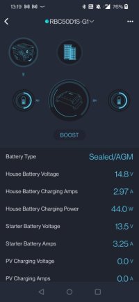

@Dellmassive this was the original app screen shot (above) the app appears to have been simplified. No nice pictures explaining where the power is coming from. Just simple text. The white background doesn't read as well for me.

you need to install the RENOGY DC HOME app.
that pic is the older Renogy APP.
get this one. . .
