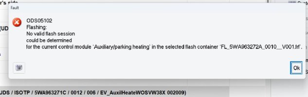

I'm trying to flash the Parking heater on my T6.1 (MY22) with this Vas6154A cable.
After some growing pains to get the Odys E 17.0.1 to work, I finally could try to flash the file Eugene kindly provided.
I followed Eugene's video, and unchecked the expected-idents box. Unfortunately, I still get this error:
Eugene thinks maybe it has to do with the "online" lock of the T6.1 platform.
Or am i missing something?
From: SW: 5WA 963 271 C
To SW: 5WA 963 272 A
