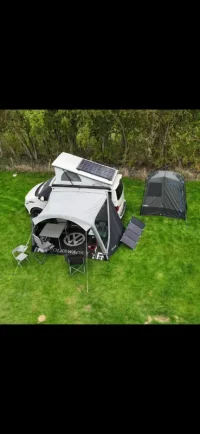

My setup for using 120w portable solar panel...no problem locking up..Cheers
I must be honest to being far too trusting when it comes to leaving my Bluetti AC180 outside in the awning coupled up to the Renogy portable suitcase panels.
It's in a waterproof padded bag, hidden behind stuff in the vanside corner of the little awning we take to forum and festival.
Sometimes there's a jormax in front for a little more privacy/security, been lucky so far, but the do's we go to are usually surrounded by forum friends.
Wifey wasn't happy about getting up the steps for this photo! This is our normal setup.
Mine goes through the grommet in the plenum chamber behind the battery with Anderson connectors, then panel wires up the front of the van (outside) to the panel which sits on the roof (sometimes).
