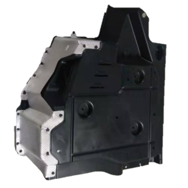

Can anyone help identify if the part hanging down is in its normal position or has something broken.
This is behind the passage side front wheel
Plastic under chassis covering torn off. Have you been through deepish water a bit quickly recently? Needs replacing as soon as you can.
If you remove it it will have the part number on it. These guards are not very strong and easily broken by driving through flood water.
If you are OK with tools you can straighten up the parts and use epoxy / fibreglass matting to make a repair, otherwise it’s a replacement.
The lower the van the more the risk of damage.
Prepare yourself for how much VW want for a new piece of plastic.
Broken undertray. Sit yourself down before you look at the price of them. :oops: :oops:
Thanks to everyone
I’m sitting down, how much to buy and replace
Depends on which one you need to replace. What I can confirm is the front panels behind the front wheel are roughly £100 each.
If it's not broken you can heat it with a hot air gun and slowly push it back into place, and then secure it with the original fixings or metal cable ties.
