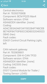

Do you see Trailer module in Carista's "Detailed ECU View"?
PS. You can send full Carista report to yourself e.g. by email using the share button 1625751772991.png
01517 - Control Module for Trailer/Towing Sensor (J345)
004 - No Signal/Communication
13632256 - Function Restricted due to Missing Message(s)
[Steuergerät für Anhängererkennung-J345 - kein Signal/keine Kommunikation]
PS. You can send full Carista report to yourself e.g. by email using the share button View attachment 122829
