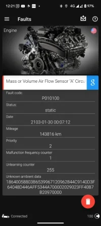

Hi everyone,

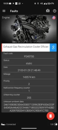

Before setting off on a 500 mile round trip yesterday in my wife's newly purchased 2016 T6 Kombi (private sale, 90,000 miles) I did a code scan on the van and a P010100 code showed up related to the Mass Airflow sensor. On the first leg of the journey, my wife did the first half of the driving and I monitored the presence of codes (as well as DPF data and other live data) and the code kept coming back. Later in the journey the code stopped coming up and was replaced with a P245700 code that then kept coming up in relation to the temperature of the EGR cooler.
The seller of the van a few days ago advised it is running a stage 1 map that includes the deletion of the EGR from the ECU. EGR blanks have NOT been fitted yet but it was/is my intention to do so. The Van seems to be regenerating the DPF just fine and drives considerably better than our other standard 150, overall it feels much more powerful and much much smoother albeit perhaps a little flat at sub 2,000 rpm at low speeds.

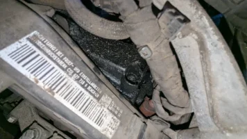

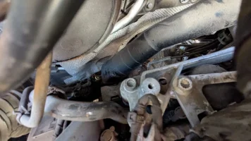

A) There appears to be quite heavy oil misting to the lower joint of the turbo to charge cooler pipe
B) I have noticed the rocker cover appears to be leaking and oil is noticeable across it's full width.

P0101 00 - Mass Air Flow Sensor (G70) - Implausible Signal
indicates that the values reported by the sensor do not make sense thus "Implausible signal"
Just need to figure out what values and why...
Unfortuantely OBDeleven screenshots are not very useful as so called "freeze frame" (a snapshot at the moment of the fault) is not decoded.
Can you find the freeze frame of the fault somewhere else in OBDeleven???

Anyways, as the most common reason for P0101 is an air leak - don't you think you actually have quite an obvious air leak (below)?
the oil misting to the joint between the turbo and charge cooler connection,
There is always tiny amounts of oil in the air intake - as crankcase breather joins air intake path just before turbo intake. Tighten up the leaking joint?
A bit contradicting information as without EGR also the EGR cooler is just obsolete. Perhaps ECU has detected that EGR cooler (coolant) pump is not performing well?
You could monitor (log) EGR cooler input and output temperatures to see if there is any discrepancies between those two (yes OBDeleven can do it).
Right, sorry for the slow response / update, I was on holiday in the van when I was trying to work out what was wrong and then I was unsuccessfully trying to get obdeleven to show freeze frames.
So..I've solved the code issues by fitting EGR blanking plates. This means that whilst the EGR had been mapped out and shut, I expect the valve was faulty/coked up and wasn't able to fully shut meaning EGR flow was being picked up when the ECU wasn't expecting any etc (put in simple terms at least)....Done 150 odd miles since putting the blanks in now, codes would have popped up in just a couple of miles previously...
Re the oil misting - the bolts holding the turbo to charge cooler felt tight enough but I gave them both another turn and I can't see anymore misting at the moment so fingers 🤞🏼. The van does sound a bit more "boosty" than our other T6 150ps though....
Probably a hardened / flattened O ring at the joint, I thought I’d seen the same leak point on the Forum before but can’t find it.
It might be worth sourcing a replacement O ring / seal now before it eventually leaks again.
