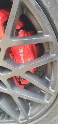

I picked up a T6 T32 Kombi 204 DSG on Saturday which is my first Transporter. The forum was really useful to help understand all the options through the search process, but now I have the van I have a few questions:
Brakes - The van appears to have red brembo calipers, are these standard, an option or aftermarket? What would be the go to pads for these?

Hi @Kevstar .... Sorry to give the bad news ..your red brakes look like standard big brakes that come with large engines and have a Brembo transfer stuck on ....regarding sound/insulation lots of good advice ..just use the search bar ...but a lots of members have brought stuff from the Sound deadening company :)

As @VanDamMan has said, those are the standard 17" chassis big brakes that take a 340mm disc. (Vw part number W7E0 615 301 F @ £101.85/1)
They have been painted red from standard and then a Brembo sticker has been applied.

Thanks for the response, my immediate thought on the brakes was that they were painted and a sticker as I hadn't seen them on others but it doesn't look\feel like a transfer.

Brilliant, that's really helpful. I wouldn't say I was blown away with the brakes so I will try a different pad.
