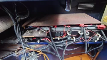

Recently been away in the other vehicle I look after the electrics in, we have a bit more space than the traditional VW seat base for our battery bay...
Yes, that's 5 110 Ah leisure batteries :cool:
The far left is the starter, the other 4 are our house bank.

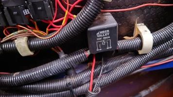

Charging wise it's mostly old school, just this monster relay energised directly from the ignition not even voltage sensing - the fancy stuff just seems not to last in the engine room

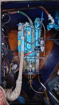

Everything powered from this rather lovely 52hp Nanni Diesel. No ECU here just a solid 20 year old Kubota block that just keeps on trucking. I think the only work we've had done on it beyond regular services is an oil ring change.
By now the clues should give away that this is our 62 foot narrow boat owned by a bunch of us. That engine has run for about 45 weeks a year for now over 20 years, so glad we took the engine advice we did when we had her built. The equipment top right is the reservoir and control system for the hydraulic bow thruster, a healthy 10hp not a wimpy 12v system, the pump is on the back of the engine between the block and the gearbox.

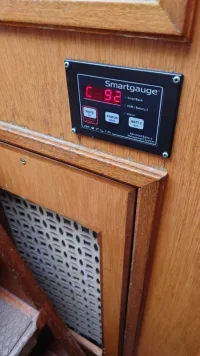

Despite the massive battery bank folks still keep slamming the bank flat, most of them are not from a camping or sailing background and treat it much like a holiday cottage. So we had a Merlin battery monitor fitted that alarms at 50%. Personally I'd have linked that to a really loud buzzer but I was overruled so it's just an indicator...

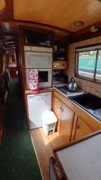

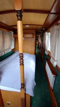

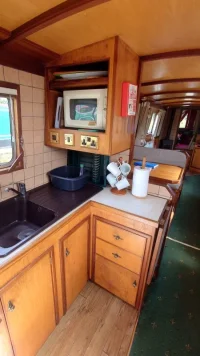

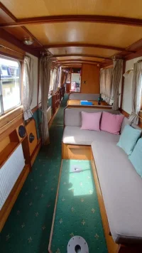

A tew shots of the inside, you can tell from the decoration the majority of the group are more retired than I am. She's smart and wearing her age well but it's a bit holiday cottage. Best antidote to modern hectic life though, at 20 tons she moves at a fast hike flat out in a canal so you can't rush. She'll do much more in rivers, much to the surprise of the cruiser crowd, but then the simple narrow boat rudder gets a bit of handful to hang on to!

I suspect there is a high correlation with those who are cost conscious and those that never look at the SmartGuage; if I had my way the 50% charge alarm would be linked to a klaxon not just a small LED but I was overruled as people felt being woken at 3am to charge the batteries may ruin a holiday... :unsure:

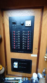

At least I have room for a decent switch and fuse panel on the boat...
