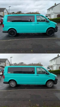

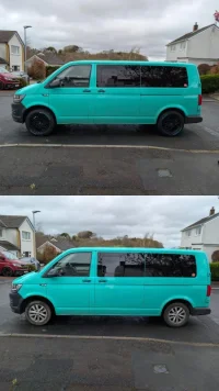

Started out with a base Peppermint LWB T6

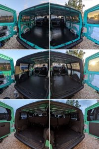

Then added windows, and a second row of seats with the help of my brother 💪🏻
Added sound deadening and insulation then got a bit downhearted when the nearside rear corner became inverted after coming out worse for wears from a fight with a car park barrier 🚧
January 2025 came around and I'd finally managed to save enough to repair the damage, I can't seem to find any photos of the damage 🤔, probably me never wanting to see it again 🤣
With my spirit rejuvenated, and our house sold, it was time to crack on with the next lot of jobs.
First up was hiding the interior metalwork with stretch carpet, adding more insulation, cutting some new panels (because the old ones weren't salvageable) and covering these in stretch carpet, along with some hidden trim clips 🫥

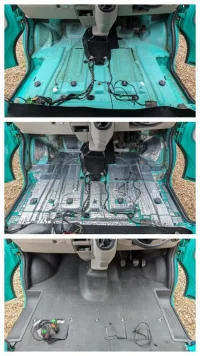

Once that was finished, and while I had the bench seat out, I sound proofed and cleaned! The cab floor. I'm keeping the standard cab flooring because we're an active family that get out and about so dirt is inevitable!
