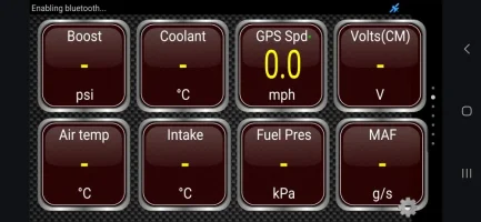

Many different parameters can be shown in real-time direct from ecu data via an Bluetooth obd reader using torque lite app or car scanner etc .
This is just an example from my phone .
You can change the type of display , colours, background, size of display HUD mode , etc etc . Also change the colour of displays if upper or lower parameters are reached i.e. i set water temp to turn to red if it reaches above 100° .

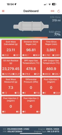

Do people panic about their soot levels that much that they need to watch them that closely?
If you see the amount of threads around of expensive engine work from not doing so...
I have no idea why something that can make such a dramatic difference to the life of the engine is not visible in the standard displays.
It's a good idea to get an understanding of what happens on your van and your driving pattern. You can then make an informed choice of if you want to monitor closely or it's not so important to you.
