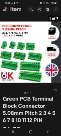

For anyone wanting get a more accurate reading for leisure battery voltage for their Renege charger and not take a chance that the machine can work it out itself then Renogy don't sell the BVS cable in the UK. I'd suggest ordering an extra battery temp sensor and cutting off the temp sensor on the end and using it as a BVS. Or find on of the terminal blocks (i think they are PCB blocks) on the internet and make your own up.

I've also never bothered with the bvs cable..... This was used for a more accurate Battery volt sensing due to volt drop over the current carrying conductors... But I've always found the units work well without it being fitted.

You don't want to sell me one of your BVS leads do you? Saves me guessing on eBay trying to find the right connector and making my own. Seem to be available on Renogy website shop in the USA but not here in the UK.
Cheers
I can't send you mine....
But this might help...?
Not 100% sure on size....
Thanks, i've ordered some from eBay to see if i can make my own. Have the batteries fully charged now (pretty sure they are going to be useless after bringdown at under 11v), but they are sat on the 240v charger at 12.9v. I've hooked up a multimeter and voltmeter to the leisure battery side of the DCC50S and both are reporting 12.9v. Still having the same issue with the DCC50S though...BT-2 is telling me the leisure battery is over 16v and giving me a big red warning. The leisure battery charge light on the DCC50S is flashing red angrily at me too! Seems that the DCC50S is over-reading the house battery consistently by 2-3v. Assign as i connect my diy BVS it shows the correct voltage through BT-2 and the battery light returns to normal.

I've made up my own BVS now which i think will make the DCC50S work ok, but I'm hoping they will help me sort out the 180Ah leisure battery that now won't hold a charge because of the charger fault.
