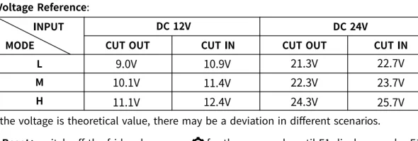

Hi. Currently away, been driving a couple of hours each day. This morning, woke up and the totalcool fridge display read F1. I unplugged and plugged it back in ( my go to!) And came back on. Battery display on it read 10.1. Is now (20 mins later)reading 11.2. The table above is from. The manual and I have it set to the M mode. I presume it turned off due to it reaching the 10.1v cut off. I have been having a Google and it suggests that thus is extremely low for a leisure battery....can anyone explain a little? Thanks.

Generally I'd only advise using the H setting here - the 11.1v cut out setting accounts for the voltage drop that will occur when the fridge compressor is running. If you find your fridge cuts out a lot then you are not charging often enough.
