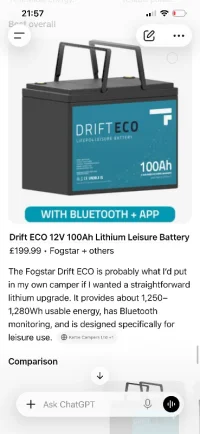

This one should be better
Whatever you do, do not buy that battery and swap it in.
That's a disaster waiting to happen. Bearing in mind the state of the electrics, the wiring is unlikely to be capable enough of carrying the current that a Lithium will try to pull from the alternator.
Take it to a professional.
You would also need a B2B charger to charge the battery while driving, and a decent mains charger to charge it up on hookup.
If you are renting a van out, it needs to be safe. And you need to prove it is safe.
I dread to think what the gas system looks like.
