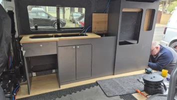

Right, I have decided I was to fit an inverter. I originally wanted to continue with team blue for integration with the Cerbo GX.
However they are huge dimension wise and Im struggling to find a place I can fit one. So thinking about alternatives.
Even the Renogy 3000W inverter is a bit too big for where I was homing to put it.
So I was now thinking 2000W renogy. This will fit where I would like to go.
Now my thoughts are, would the Renogy 2000W inverter be able to run (not all at the same time) things like a smallish (1800W) induction hob; coffee machine; microwave; small kettle etc.
Priorities pretty much in that order. Or would I regret making a 3000W fit?
The alternative, would be an Ecoflow/Bluetti or similar. The disadvantage of these is that I wouldnt be carrying them round in the van all the time, so impromptu coffee breaks would need a bit more planning.
