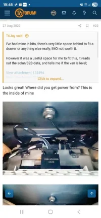

Ok so I've found some photos for reference. (Apologies for gratuitous 'dump')

To make life easier I then pushed in (towards front of van), the 'Cubby Hole Blank or Blank for Leisure Heater Controls etc' next to the Head Lining at the rear. Some say it's moulded in and you cant unclip it, but it's not (well not on my T6.1) and I've put a photo below to show the clips so you have an idea. If you push from the outside and try and work from within the cowling to ease the clips off it will give.

Antenna should just unbolt and lift off. (Some photo's show cable connection and bolt location)
Top tip that I did was, when removing the cowl surround, the rear clips (towards rear of van) are an absolute PITA!!!!!! (See phot 8 just before the sound deadening on roof) to get off without fear of snapping something. That's why I removed the cubby hole blank. Then from where the light/SoS bits go, I slid up a robust flat bladed screw driver and use this to help prise/release the clips rather than just pull on it for fear of snapping something. I slid it between the bottom of the metal clip, and the plastic tang and kind of twisted to help force the tang out (you'll get the gist I'm sure).

Edit to say you can just see where plastic (Let me break if you force me) Tang, goes into one of those VW metal trim clip/grips, hence use of screwdriver rather than just yank it off.
Edit to say now I've looked at this last photo again, you may??? have to remove or loosen off the front of the Head Lining to gain access to antenna connection. plenty of guides on here but do PM.
