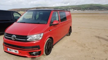

so I know it can be done but what does it look like... can anyone who has a Hilo with roof rails share some pics of them on top and how they bolt onto the Hilo roof?
They’re just bolted through the metal frame that runs around the underside of the roof. Make sure the bolt holes are sealed though ;)
FBAECAEB-13EB-4944-B1FC-39CF4820CABA.jpeg 430B6CCD-2729-4670-83FD-E2110650DB5B.jpeg 1D482D8D-5D4D-4589-9F1D-B2FE461A3819.jpeg
