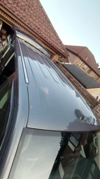

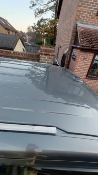

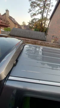

This is from when I fitted the second rail, you can see it sits quite low in the channel but also the way the rear is very slightly taller than the roof as it gently curves down the last 6 inches to the rear.
