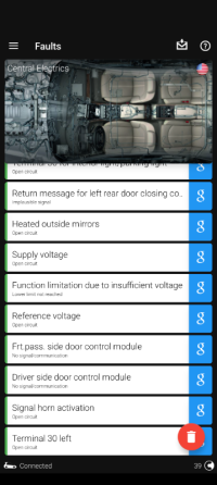

Hi all. Just wondering if anyone can help or shed some light on these faults. I had a mobile mechanic/auto electrician look at my van yesterday, fiddled about for an hour and left (fault not fixed)
Scanned the van this morning now getting multiple fault codes, see pic. And the drivers side window doesn't auto open or close now.
He was fiddling around in the engine back, under the steering wheel and internal fuse box. Has something been unplugged somewhere? HELP PLEASE.
Thanks
All saying open circuit would make me think something is unplugged. Have you checked behind the steering wheel that the BCM modules are all plugged in correctly. In a T6.1 they are high up behind the steering column but I believe lower down on the T6 and T5.1.
Have you actually tried to clear them and see if they come back ?
He may have unplugged something or pulled a fuse while looking and everything could be fine
Will have a look,
He cleared all the codes last night, after checking a fuse, and behind steering wheel. The EML light came back on this morning on way to work, I cleared them once I arrived at work, will see if they come back but the AUTO window up and down on drivers side still don't work, have to hold the button
