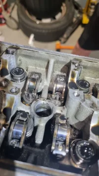

My main van is a 05 128kw AXE T5 transporter LWB 4motion 5 seater 6spd manual with almost 600,000km on it. I believe its the original engine. It still goes but requires a lot of things done so I am shortly going to retire it. I already purchased a really nice 2010 T5 LWB CFCA Auto 5 seater with quite low km for the right price. Its got a buggered engine. The guy I purchased it from just spent a whole lot of money on it..dpf, injectors, new turbos, egr..ect..but the poor fellow was fisted as the damage to the engine was already done.

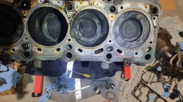

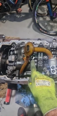

Anyway..I have already rebuilt a CFCA myself before..its actually still sitting in my shed but I have sold it, so I will pull this motor and do the same. Rebore. Recond head. Bearings, oil pump ect..

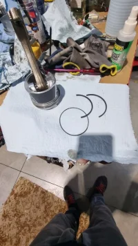

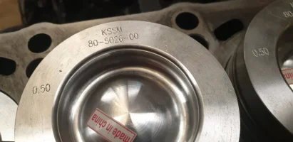

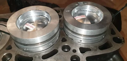

Hi. Yes I had it bored at .5mm oversize as those were the only pistons I could find at the time. I got some off ebay. They are probably Chinese but they appear pretty well made. I did actually use Mahle rings in them as I misplaced the ones it came with. I have the front of the car off now and I am about to pull the engine out. Pistons cost me about $400 posted. I beleive most of the newer vag 2.0tdi engines share pistons and most engine parts so look around.
I would have used these pistons if I had seen them at the time. I purchased mine over 2 years ago

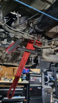

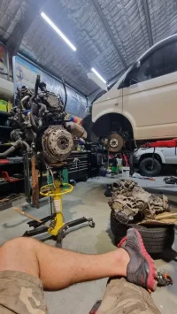

And here is where I am at now. Front end pulled off. I don't have a hoist so I'm going to lower the subframe on the bolts a little as they are quite long and pull it out the front. The old EGR is version A.

Oh you have a hoist. I think it might make the job a little easier. I'll see tomorrow how the engine comes out the front with an engine lift. I'm leaving the gearbox on and I'm not taking the steering rack out..only lowering the subframe on the bolts a bit. I did take the ac compressor off the give it some more clearance. And the rear engine mount completely off at the block. I did price Chinese heads complete with valves and cams for about $1200. I am hoping this head is ok as it had pretty good compression readings..about 23 to 25 bar. Apart from the cylinder that dropped the rod out the side of the block. I also have another head that has done 120,000km so between the 2 I will get one good one. I am kind of doing this on the cheap.. if you hadn't already guessed, I am still looking to build a good strong engine however. Low km written off t5 and t6s are still bringing strong money at the auctions. Id expect you would pay at least 5k Au for a low km vehicle..no matter how badly damaged it is..or you can rebuild yourself if you are handy for about 2500..depending of course what damage there is. My donor engines crank was still in good condition and just required a polish. Not bad considering the bores were very bad and there was obviously a lot of contaminated oil circulating in there for some time. I'd rebuild yours..then you know it's done. Get rid of the egr completely and I'm going to also make a dpf delete pipe for mine.

I have my rebuilt engine in now. Just hooking up the ancillaries. It came out easier than going in. It needs to be on a bit of an angle so the gearbox is a few degrees lower. The engine stand also hit the back of the top of the firewall but with the help of 2 rolling jacks I was able to shuffle the motor back enough and get the gearbox mount bolted and then it was easy to get the other mounts bolted in. I did this just by myself but another set of hands would have come in handy
The cylinder head off the original damaged engine must have just been replaced as it looked perfect. I couldn't see any damage where the piston hit it which is really strange as one of the pistons definitely decided to leave the rod. I pulled the whole cylinder head complete with the turbos and manifold and that's the way it went back on to the rebuilt short engine. I replaced the egr cooler with an all aluminium one from the amarok. It was about $80au delivered from ali and it actually looks pretty decent. It came with a filter though I used a Mahle in it. The rear steel coolant pipe did hit the housing just so I had to dremel cut the left side support bracket so it could be moved back the 10 or so mm it needs, otherwise it was pushing on a joint where the thermostat housing is. I will use a spare hose to connect the unused original coolant feed pipes instead of the elbow that you get in the kits. That tee/hose size is 20mm in case anyone was wondering

So I managed to get the motor and box out was pretty slow deciding what did or didn't need to move or take off, once I finally got the box and motor out I had a hell of a time separating them I tried to leave to beavel box attached to motor and remove only the gearbox how ever I couldn't fully remove the shaft appeared to catch a circlip on possibly a seal so I had to get the 2 pieces back together and remove as 1
I'd have had 2 days at it to get to here 😆
I'd say my engine was moments from failure found 2 exhaust valves about to let go
So up for some type of head work barrels just look quite glazed up
The last time it was running in the drive way I noticed a tic noise that was new too me
