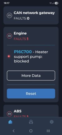

Heater support pump bocked
Lukefx
So whilst fixing one issue another one pops up!
Supposed to be doing a longish drive at the weekend, but not sure now.
Can anyone advise please, what does it heat, support and pump?!
Thanks.
Secondary engine coolant pump?
Rear HVAC heater pump?
What's the van spec?... Vel with rear heating?
Intercooler water pump....
Thanks Dell. It's a 2016 T6 150 Shuttle with a reat HVAC.
So by the sounds of it it relates to a few possible pumps.
The post above seems to relate to the support pump in the engine bay for the charge cooler.
The rear HVAC was just a guess.
But it's shown as a fault on the engine ECU and not the HVAC ECU...... So it will be the front support pump..... Have you been loosing coolant?
Though a vcds scan will get you a better Indication.
Your code looks like a carista screenshot?
Yeah I thought that too, engine ecu and not HVAC.
But not loosing coolant and not running any differently, not that I've noticed anyway. The engine light came on and then I scanned it and yes, Carista.
I'll get it scanned properly.
Thanks again.
