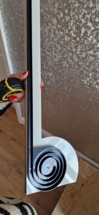

Hi. Just seeing if anyone has had any issues with their kitchen/units from VanFurniture?
The units are great and happy with the colour and set up, all built and went to put in the van (with a pro at hand) and the wardrobe unit doesn't seem to be sitting right! Seems to of been cut too short, abbit 2-3inch gap at the back..just wonder if anyone has had this problem before? It's the slimline kitchen/units on a sub T6.1

Think your floor's a bit thick from the pics. If 20mm or so was lopped off the bottom of the units would it sit down and back OK?

I'll check but it's the same ply and floor size our friend's camper shop do and fit these units so I'm not sure, thank you for the advice

What have you got under the ply? How thick is your insulation? Definitely look like they're not sitting low enough.
Think we just found the problem! ..the piece inside the cupboard with the roller blind on hadn't been cut in production :/ was hard to see as it was inside the unit , going to cut it now as it fitted pretty good when we took it off
