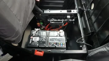

Yes its a factory second battery for connecting Leisure related equipment.
Normally fitted under the seat depending on the type of van.
They have started fitting EFB+ battery's and still use a split-charge-relay (SCR) setup.
Its worth getting the factory fit kit, then upgrading the SCR to a DC-DC charger if reqd (as @Loz mentioned)
here is the factory split charge relay setup on a Panel Van:
