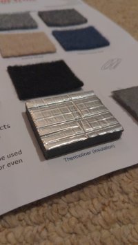

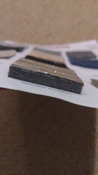

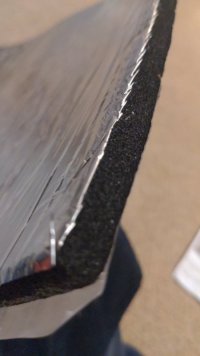

I bought a samples sheet from Harrison's the other day. It has some thermo liner on it...
I also bought some dodo mat thermo liner, 12mm so about twice as thick.... Not great photos but hopefully gives you a better idea of what you need.

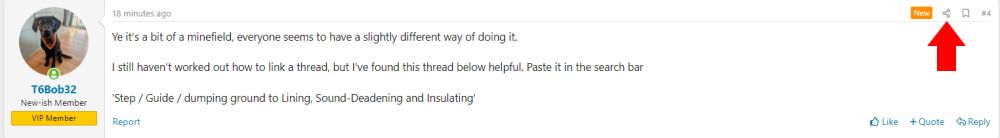

I still haven't worked out how to link a thread
Hover over the "share" icon on the post you wish to link to (as indicated below), click on the address in the pop-up that appears and then copy/paste it into your post. :thumbsup:
