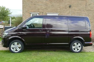

So was hoping to post this before Camper jam but didn't complete until Thursday night before but here it is my conversion

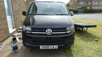

So started looking for a 150 DSG Highline van in blackberry
bought said van

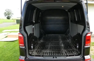

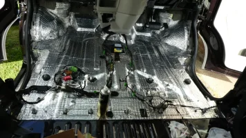

Next was to remove ply lining
and bulkhead.

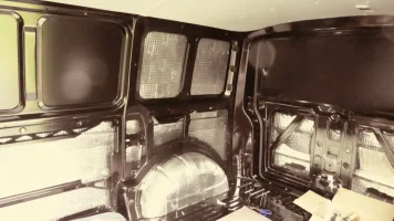

once removed I set about silent coating every thing probably went a bit OTT but each to there own.
And then decided to stick 6 mm isolator all over.
Again a bit OTT

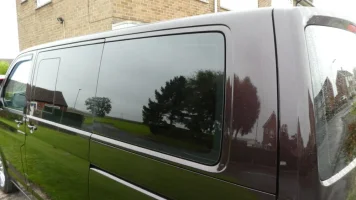

So next job was to take the van to Exploria for the windows fitting decided on VW OEM as I prefer the look.
They did a great job fitting the windows

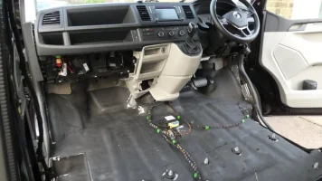

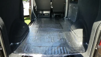

Next was carpet lining a few harsh words was said while doing this.

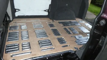

Then it was onto the floor i used the old 9mm ply from the van lining kit.
I made a template and cut all the raised areas out also added a bit more silent coat for good measure:) and some dodo insulation
Next was a condensation barrier every were.
then 12mm ply ontop.

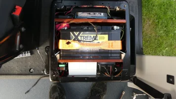

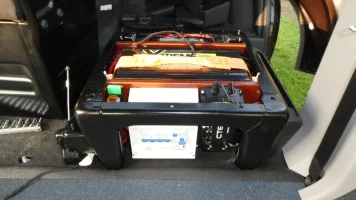

Then onto the under seat electrics bought from Travelvolts. This took a while to configure as i wanted it all to fit under the drivers seat a 110 amp battery. A mains hook up RCD unit. CTEK Dual 250SA battery to battery charger. and a victron IP 65 mains battery charger.
It was a tight squeeze:eek:

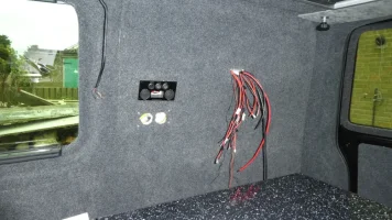

Then more electrics into the back of the van the kit i used was from switch panel.

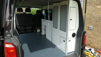

EVO units built ready to go in the van. units are good quality but I only received A drawing of the units didn't seem to be any building instruction telling you what went were.:confused:
Really chuffed got them in wiring wired up and all worked. Happy days :)
