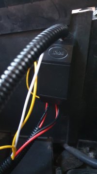

Cheers. I seem to have solved it by trial and error. They came with no instructions so I found some on the forum. I put the red cable on the battery positive, black to earth and then I had a white input cable and a yellow output. I connected the yellow to the grey headlight wire (wire 10) and the white to the green wire (wire 1). It all worked OK and dimmed when lights came on etc but just pulsed when driving. I tried a few fixed and soldered all the connections but no fix.
Eventually I disconnected the white output wire from the green headlight wire (wire 1) and connected it to the yellow input wire (so both wires connect to the grey headlight wire (wire 10) and it seems to work fine. Unsure why but it's a fix!
Images show the wires coming out of the box as it came and an image of the white wire soldered to the yellow wire, insulated and tucked away in the conduit.

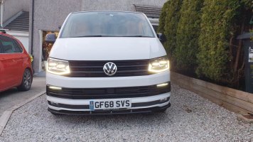

Haha yes, new plates are on the way. Not had the van long, spent so long faffing over which wheels to get, everything else is on standby!
