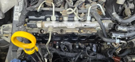

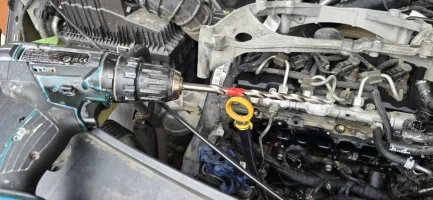

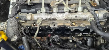

I've got the glow plugs out - stripped top of engine off including the fuel rail to get the necessary access to the glow plugs.

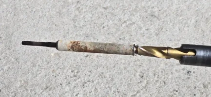

I drilled the broken ones out with a selection of long drill bits, upto an m9 drill. I then tapped the threads back out with an M10 tap.
This isn`t a job I would like to do again and certainly not one for the feint hearted. !!!
You have to snap the tops off manually - one required drilling all the way out - the other cam whizzing out on the drill bit.
