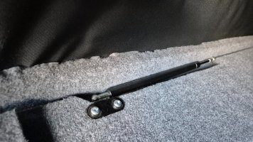

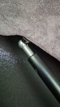

T The Bear78 150 000 miles and just broken in! VIP Member T6 Legend 25 May 2025 #2 When I replaced my tailgate struts, they didn't come with the ball end. I just swapped old for new, leaving the ball ends fitted to the van. Is this a bonnet strut? Do the old ones have a hex section similar to this?

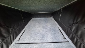

Aliceincamperland Member 25 May 2025 #3 The Bear78 said: When I replaced my tailgate struts, they didn't come with the ball end. I just swapped old for new, leaving the ball ends fitted to the van. Is this a bonnet strut? Do the old ones have a hex section similar to this? Click to expand... Sorry, I didn't say...this is for the bed board

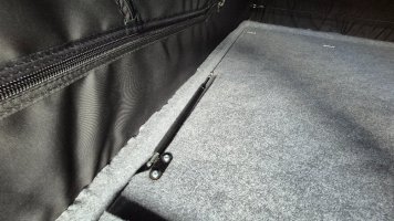

Dellmassive T32 204 DSG LWB SLN PV MY18 & T30 SWB KMB MY67 VCDS User Moderator VIP Member T6 Master 25 May 2025 #4 Bracket on the bed board. And a nylock nut on the roof frame.. ... ...
Aliceincamperland Member 25 May 2025 #6 Just looked it up @Dellmassive how did you attach it ? I can't get to the backside of the area I'm attaching it too??

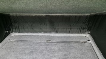

Dellmassive T32 204 DSG LWB SLN PV MY18 & T30 SWB KMB MY67 VCDS User Moderator VIP Member T6 Master 25 May 2025 #7 It's bolted on before the carpet lining is finished off. You will need to drop the trim surrounding to get to the back side of the frame. Post some pics of what you have. What's the situation? You have a roof fitted without a bed board?

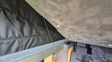

Aliceincamperland Member 25 May 2025 #8 Y Dellmassive said: It's bolted on before the carpet lining is finished off. You will need to drop the trim surrounding to get to the back side of the frame. Post some pics of what you have. What's the situation? You have a roof fitted without a bed board? Click to expand... Yes. Roof with no bed. Trying to save money and make myself!....thinking we need two jack nuts?

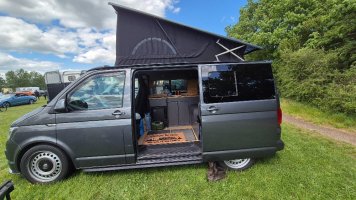

Dellmassive T32 204 DSG LWB SLN PV MY18 & T30 SWB KMB MY67 VCDS User Moderator VIP Member T6 Master 25 May 2025 #9 We had the bed fitted as part of the roof. Three hinges at the rear. And two gas rams on the side. With cutouts for the rams. ..
