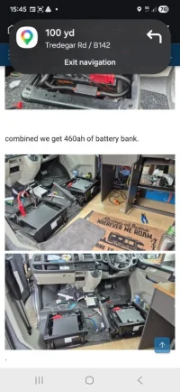

Those are what I used off both my battery's..
Remember the fuse is to protect the cable.
See here...
Perfect, that's exactly what I'm looking at - so I'm right, I don't need a positive bus bar and can just have all my midi fuses in that box, to protect all of the wires
