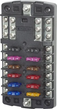

I am going to place a 12 way Blue Sea Systems Fuse box behind my furniture, fed from a 16mm live flex cable. Is it better to buy one with the negative bus bar built in, or a waste of money considering the other option is just to run the negative 12v cables from each device to the nearby ground point in the rear of the van, and the negative from the blue sea box pictured below, would have to go there anyway?
You can use either.
I personally used the one picture above with the included negative busbar.
I then run the appropriately sized two core flat cable out to all the devices.
That way it kept all of that connections and fuses in one place...

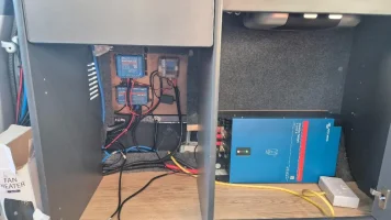

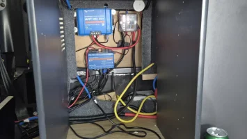

I've got a couple of those one is under the driver's seat and the second one is behind the fridge.
Thanks, thought that would be best. Did you run the main negative back to the leisure battery area, or just to ground nearby?
No I run the negative direct to a chassis point right next to the fuse box.
See here ..
