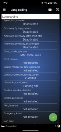

Thanks so much for all your help, I found the thing I missed probably because it's called control module for towing sensor!Screenshot_20230219-193142.png

Hi, the coding did sort it. I had missed one of the modules off which was causing the fault. The problem I found was the instructions didn't match the module descriptions.
