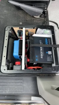

I’ve got Orion DC to DC charger and MPPT which are going under drivers seat base. How have people fixed these to under the seat?
I’m thinking self tapping screws potentially. I have seen other people using ply also?

There's an entire thread of seat base installs here for inspiration.
That thread has a load of ideas. You can mount ply to the sides or a fix in a cross board depending on your requirements. Kiravans make some brackets to mount a board on if that fits your plans. My setup:
