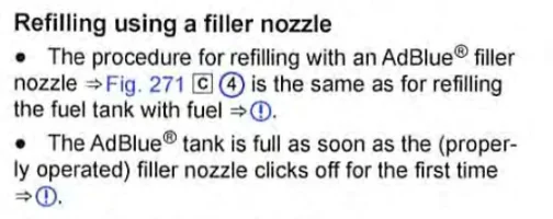

Sorry to be asking another dumb question. Mostly I'd filled adblu from a can & I've to be careful not to overfill it. I've notice a garage with an adblu pump on one of my regular routes.
Presumably do these pumps shut off automatically when it's full so not possible to overfill?
I realise that some have had some problems but why not just let the pump do its job? The reason I query is that when I fill from a bottle I just let it do its own thing until it stops, what is the difference I have never had a problem with that method but I have never used a pump?

No. If you used a pump, when the cut off was reached the tank will already be over filled..... Ie liquid up in the neck.
Just fill up what the dash says, no more.

The ones I’ve used allow you to select the number of litres and it will auto stop at that. Or just manually stop it from the screen. Do not fill more than the dash says and do not rely on the pumps auto stop as that will be too late. Over filling is the cause of many issues.

The pump wasn't faulty, it knocked off as soon as the level got to the end of the gun, i.e. top of the ad-blue filler tank. Which is the whole point, the tank is "full" before the actual level gets to the top of the filler, by that time the tank is overfilled and the system is confused. If it was just a case of filling the tank until it was full, VW wouldn't have gone to the trouble of putting a display on the dash telling us how much to put in.
The pump worked as it should, i.e. it stopped when the tank was brimmed.
On the T6, you shouldn't brim the tank.
Ergo, do what the van asks, not what the pump thinks you want.

Rarely use a pump as it's more expensive over here. I use 10 litre containers to fill to the brim. Then the AdBlue level when the flow stopped is within reach by finger. Have been doing this 9 years now (on several T6) without issues - simply can't reproduce the AdBlue fault by filling to the brim - so perhaps the issues arise when not replenishing to the brim ;)
And, indeed when brimmed the amount of AdBlue filled is about 4 litres more than shown on the dash.
