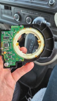

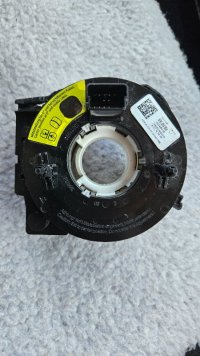

Thanks both. I replaced the original with an aftermarket clock spring. I've just called the seller and they've said the part I have is just the clock spring, not steering angle sensor. His suggestion was to transfer the steering angle sensor from the old clock spring to the new one.
Is this actually possible?
Photos of old and new sensor attached.
Yes, see below.
Reactions: mmi
So it is, thanks for your help. Just need to figure out how to get this into the replacement and it should be sorted. I'll update how I get on.

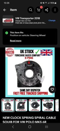

OK so turns out that the clock spring I bought isn't able to take the steering angle sensor, they just won't fit together.
So does anyone have any recommendations of anywhere to get a more genuine replacement, new or second hand. VW want £318, and there are a few on eBay but they won't arrive for weeks.
Biting the bullet and getting a VW part. Can't waste any more time messing around with ordering parts that don't turn out to be right.
