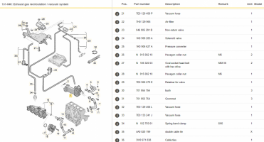

Good morning All sorry had no time to search I’m late for work, can anyone post me the part number for the OEM EGR valve complete or advise best place to buy 1.
