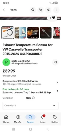

Thanks. The sensor is in the EGR cooler "cold" end. Close to coolant bottle.
Very similar to this below
Would this be suitable for a replacement the digits are the same but last 2 letters are different.
Thanks
Thanks
Unlikely. The digits indicate only it's an exhaust temperature sensor - the letters identify exact type. If you would examine the other four exhaust temperature sensors on your van - they all have different suffixes.
error code P041B00
The code suggests implausible signal - have you checked what temperature the sensor shows at ECU? Wiring issue perhaps?
No mate im a plasterer🤯. It's been in the garage 3 weeks and they said they checked wiring🤷‍♂️ so not sure. I've found the same product code now so think I'll just buy a new one.
