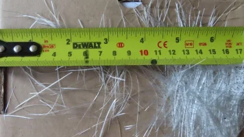

I don't know how you lay up fibreglass or what with but usual mat is not just millimetres, here is a random sample. ( mainly 50 - 100mm strands )
I suggest that you do a little less reading and carry out practical laying up before saying that. If the glass were only millimetres there would be no strength in the structure.
