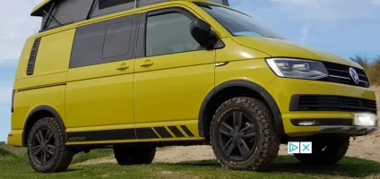

I am still thinking of that Semi Swamper look for my T32. I like the OZ Rally Legend’s, but actually really like the Devonport’s on a local can too.
Ignore my ignorance, but are these suitable for a T32 T6?
If so, what’s the widest tyre that I can get away with. I want the rugged look but still tarmac friendly, so thinking Wildpeak’s perhaps?
What do narrower wheels feel like compared to my Sportline wheels with 255/45/18’s?
Perhaps a really obvious question, but are the bolts and locking bolts from my Sportline’s suitable for using with my new Devonport’s?
They do look cool, fair play.
K02’s are a touch chunky for me though, given it will be 90-95% road use.
Yellow sidewall lettering is superb on that photo too.

What about the Michelin Agilis CrossClimate…. they do them in 17” and they’ve definitely got more of a rugged look than the regular CrossClimate range. There are members on here using them and rate them highly. If they did them in 18” I’d definitely consider them. Here’s a picture I found quickly on Google….

Thanks guys. Having read more reviews, including the Agilis CC, I think the Wildpeak’s are what I want to go for. The second choice being the Yoko Geolander’s.
I went for the 225s on anthracite Devonports with std centrecap and bolt covers just to make it subtly different. It was already on -40 H&Rs

Just to keep the rolling radius as close to OEM as possible to minimise impact on speedo albeit this can be adjusted with VCDS. Its something I need to amend as the speedo does under read slightly. At a registered 70mph GPS says 72.
For a given aspect ratio, the height (rolling radius) increases with width.
Ok. Makes sense. I will go with 235 or 225 I think. Seen others using 245 but that seems nuts on a 7” wheel.
Yes, the height is a percentage of the width, so 235/65 is about 6.5mm taller than 225/65.
