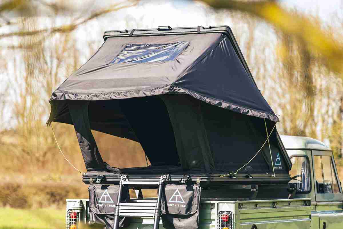

Hi. I understand the quandary as I went through this whole journey myself with my van. Bought it new and didn’t have roof bars, but then a year later did the ‘oh no should I have specced them?’ thing. I wanted a safari style awning as I deffo did not want to drill or bond anything to van, plus I love the simple engineering and look of them (each to their own). So after much deliberation after promising myself I would ‘NEVER’ spend that much on a RR bought a bloody ARB Base rack. 🤦‍♂️🤦‍♂️
I have a roof tent and awning from these guys:
I found the awning exceptionally well engineered for money. Mine lives on the van 100% and it’s my daily too so personally I’d not be too fussed about taking it in and off.
Re: fitting to your rails again from my own experience as an engineer, after fruitless searching with a view to fitting OEM rails I decided it would be best to fabricate my own mounts.
Then I saw Tent and Trails slimline Roof Tents and was sold hence why I went down the ARB Roof rack route.
