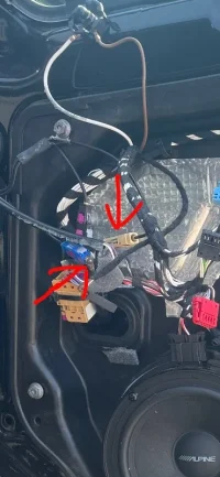

This is the wiring in the drivers door.
Are these two connectors my GPS and DAB aerial connectors for the wing mirror?
I do have a square plastic bulge at the front on my roof (under the skyline poptop). So not sure what should be in there?
