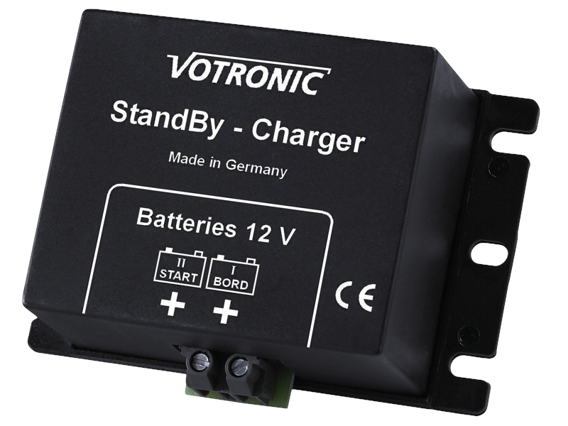

Thanks. I guess I should look at a way to connect my Mppt outputs to my starter batter.
That looks like exactly what I'm after and it takes small cables which is ideal. Many thanks
Not sure how your set up is wired but I have one of these connected to the Load output on my MPPT controller. I've configured this output to only be on when the solar panels are active so my starter is only charged when it's sunny.
@Deaky I notice in the information leaflet for the Votronic 12V StandBy Charger that it is not suitable for Euro 6 vehicles.
My error -- I missed the fact that there were two different items on the information sheet, the 'Not suitable for Euro 6' bit refers to the 'D+ simulator' not the Votronic 12V StandBy Charger
Where did you see that I've just looked and can't see it. Best to double check before I order it for my euro 6
Sorry, -- I missed the fact that there were two different items on the information sheet, the 'Not suitable for Euro 6' bit refers to the 'D+ simulator' not the Votronic 12V StandBy Charger
My entry above is now corrected.
If your MPPT controller has a Load output you could connect that to the solar input on the Ctek to achieve charging of the van battery.
