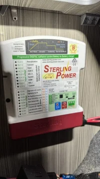

I seen your reply to the other guy asking not so long ago and yes my Sterling has the LiFePo symbol on there also.You have an EC155 and a Sterling DC-DC charger.

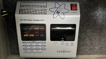

As covered on quite a few other threads this will only let you use a conventional lead acid leisure battery as is.
Depending on the model of the Sterling (please get a clearer picture of the front) it may be LiFePo capable, but the "charger" built into the EC155 is just a 13.8v power supply and isn't really compatible with lithium.
Moving to a LiFePo based system will mean you need to ensure the EC155 "charger" is off (ideally disabled) and a LiFePo capable charger like a Victron IP22/IP65 charger is fitted to charge off 240v.

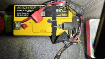

Ordered the Numax 120ah, like you say the system is working and not let us down so why change anything.So that Bison battery looks like a Group 31 size battery, they don't seem that available online but this link seems to give a size reference:

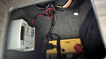

So any of these should be a direct replacement. Your current battery has the dual terminal type (post and bolt), but you are only using the post:
110Ah / Group 31 Leisure Batteries
We sell 110Ah / Group 31 Leisure Batteries at the cheapest prices anywhere. Our 110Ah / Group 31 Leisure battery is an extremely high quality product at a budget price. With a price beat guarantee you can be certain of the best deal in the UK.www.tayna.co.uk
Whilst not listed as a Group 31 this battery from Numax seems to have the same case size but 120Ah capacity:
