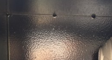

Thanks for the advice re: battery usage. I am still struggling to get to the battery to check or replace though. Apparently it is accessed via the gas locker (see picture). Any idea on how I might do that?
Have you got some wider view pictures?
That seems quite a sealed gas locker unit so I'm wondering if it's behind it rather than through it?

Still struggling with this. Additional photos below. Is it most likely that I get to it by removing the gas locker entirely?
When I trained in injuneeering a flexible hose should only be used through a maximum of 90 degrees and the bend shouldn’t start at the coupling.
Who did the conversion?
Often it is the floor of the cupboard that lifts up.
