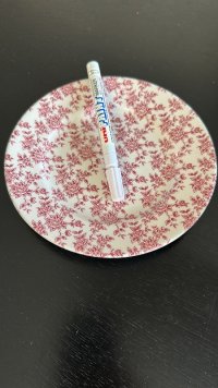

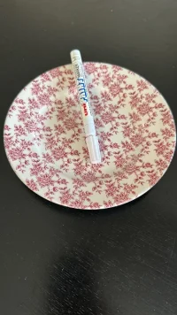

Seen a lot of people asking about fitting OEM caps to Navis holeys. I just used a plate right up to the cutaways with a paint pen and used a stone wheel.
Worked really well and caps are holding nice and tight. Just hope this might help someone wondering how to do it.
