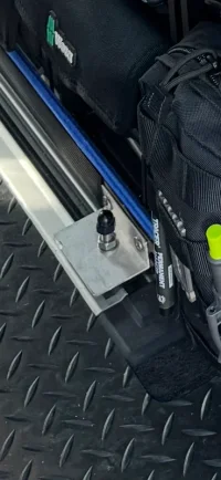

I custom made 2 units out of extruded aluminium and 3mm aluminium composite panels. It can sleep 2 people as single beds. The units are bolted down to the seat rails so can be removed individually.
I like having the centre isle clear so we can walk through the van and be able to fit full size sheet materials without removing anything.
Where did you get the metal frame from that you used to build the unit's? (Can you recommend a suitable weight supporting thickness?)
Also what method did you use to bolt it down?
I've seen these I was considering but they're pretty expensive:
BR 30 x 30 Black anodised profile - KJN Aluminium Profile << I opted for 30 x 30 mm as the 20 x 20 would be too small for the size units I built and anything larger would have affected the storage space for the dimenions I was working with.
I used the fittings you linked to by Stee FRee. They worked well for me. I used steel L brackets bolted to the alluminium profile with the T bolts passing through it (if that makes sense) I also drilled the alluminium profile in some places to allow the T bolt through the profile then added a bolt.
You could make your own T style fittings to make it cheaper I think.
