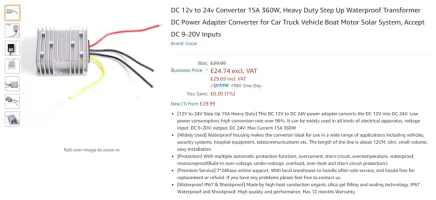

in the example : DC 12v to 24v Converter 15A 360W, Heavy Duty Step Up: Amazon.co.uk: Electronics
the specs state:
input: DC 9-20V (so volt swings from regen braking should be ok)
output: DC 24V; - Max Current 15A 360W (this implies a regulated output)
protection function, overcurrent, short circuit, overtemperature, waterproof, moistureproof(Built-in over-voltage, under-voltage, overload, over-heat and short circuit protection.)
if you up for a bit of Mcguivering , then get one of these 12/24 dc-dc and start testing.

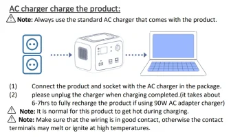

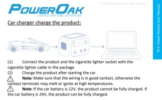

@AK06FR : the specs below say different: they look the same as the Ps5 ?
car: 24v ok cant charge on 12v ( 14 - 40 v ? )
mains : 90w 6-7hrs
solar : DC14-40W / 120W
PowerOAk - PS6S
I think that could even be a typo in both manuals, more likely can't be charged if 12V, can be charged if 14V. But identical charging electronics me thinks.
