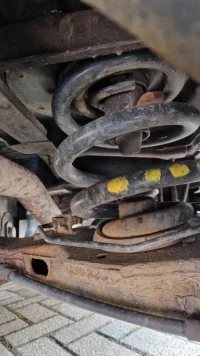

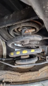

I was under the rear of my van (T6 T28) to replace the spare wheel and I noticed what appears to be part of a broken spring at the top of the rear coil springs, on both sides. They are obviously a smaller diameter than the main springs, so what are they?
Thanks

The top of your spring has snapped off and the spring will have to be replaced. It's an MOT failure.
Worth checking the front ones too.
