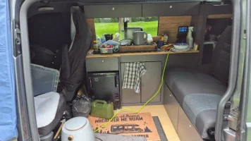

Hi folks,
Back again on the forum and looking to add an overbed locker to our Multivan. I have built the locker from Evo Motion and now wondering how best to mount... At the front of the locker I have good mounting points but at the rear (tailgate), I am debating options.
This is the locker...
Evo Motion Over Bed locker
Should I,
- Mount ply squares to the metal frame with Sikaflex 221 and then use brackets - will this be strong enough?
- Use self tapping screws, mounting brackets straight in to the metal frame? is there anything/ any electrics I need to watch out for?!
Thanks all!
Maybe consider using rivnuts into the metal frame? Would be super strong (assuming the rivnuts were fitted correctly!)
Thanks all! And with rivnuts, is there anything in the frame I need to watch out for when I drill?! I am assuming that there is some wiring in there?
The wiring loom usually runs on the outside and then down inside the C-pillar - there's plenty of holes in the metalwork to be able to view the cavities though so you can double check before you drill anything.
