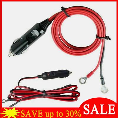

I’ve also got a cheap Aldi Auto XS ‘smart’ 5A charger that I keep in the van for trips away and on a couple of occasions have used it to top up the starter battery when we’ve been parked up in one place for a while and it’s charge has started dropping. It was cheap and while I wouldn’t want to leave it hooked up all the time, I think it’s good for the odd top up and saves having to run the engine. The problem with the Aldi charger is that it only has hard wired crocodile clips and I prefer the more convenient route of plugging into the 12V socket. I was thinking about cutting the crocodile clips off and replacing them with a 12V plug - something like this which is supposed to be 15A and is already wired. Would that be OK?
I’m also wondering what to use to connect it to the charger. I was thinking about just using a couple of Wago 221 in-line connectors but am conscious of the fact that they will be exposed unless I wrap them with tape. I could also use insulated ‘bullet splice’ crimp connectors but guess they would also need wrapping. The other issue with that approach is that I’ve only got a cheapo crimping tool (the cheapo ‘£7 flat 2mm steel’ type). As an alternative, can anybody advise on a suitable detachable connector (similar in function to those used by Ctek) with screw rather than crimped terminals (due to the lack of decent crimper). For what it’s worth, the charger and cable will only ever be used indoors.

Solder splices are good for joining wires, will give a good connection and environmentally seal.
Nothing wrong with what you are proposing.
You can also actually buy 12v cigarette plugs with screw terminals.
@EAN. Thanks for that - I've ordered some solder splices and the plug with fly lead which should be here tomorrow.
@Pauly - I suspect that will be the fallback when I find that the heat gun also melts the plastic sleeving on the cheap cables that they used on the charger and/or 12V plug that I've already ordered!

f you've access to a chefs torch or hobby/smaller gas torch then try that OR even a really good hairdrier but that might take ages. Some of the heat guns have a metal shield to direct it into a rectangle shape so that could aid the focus away from the cables etc
@archersam - I've got one of those but never thought to use it! I've also got a couple of 'turbo' BBQ lighters which push out a very hot focussed flame that might also do the job. I'll have to do a bit of testing. As the old saying goes 'every day's a school day'.
