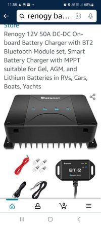

DC-DC charger...

That Combo will see you though a whole day,
Charging all three batteries when mobile,
Then a 2hr drive will have the van lithium fully charged.
